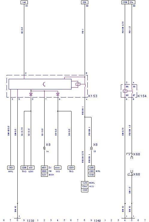

Yes, think it maybe K153 / K154 in the under wheel fuse board but im too tired to really study TIS tonight.

Easy enough to change the delay I suspect by changing a resistor in the timer.

Heres the diagram
Note the larger timer chip which in turn switches a relay for the rear accessory socket
So if the glovebox and boot light are turning off after the correct period of time then its the relay at fault, if they are not its the timer device

If the relay is permanently energised then it will draw some current....not massive but some.
If the contacts are permanently welded together then no.
It could also be a door switch or similar which is causing the timer not to time out (it has inputs from door switches etc)

ISTR there is a group of 3 "relays" behind the fuse box up under the driver's side footwell. One of these is the servotronic control unit (6 pin device, IIRC). Another of these (an 8 pin device) is the timer itself (K153 in Mark's diagram). The socket itself is fed via K154 which is a 4 Pin relay and the lowest of the 3 IIRC.
So, K153 feeds all the interior lights, etc. and energises K154. K154 feeds the socket.
Could be either K153 or K154 faulty, depending on if the interior light circuits extinguish after the timeout or not. If the lights don't extinguish, it's likely that you have a drain on the battery since K154 will be permanently energised.
Easy to test the timer. Leave the boot open. Light will extinguish after 10 minutes or so. Press the pillar switch on the boot lid. Light should come on for another 10 minutes and then go out.
If you want a permanent socket supply, just remove K154 and bridge the contacts with a piece of wire with 2 spade connectors on.
Disclaimers about not flattening your battery, etc.  Wink

Right, Investigations stared and concluded and the result is :
No Fault Found  Grin Grin Grin
Several tests done,
1, Left glovebox open, locked and left.
On return, glovebox out, plugged in a phone charger, was active.
Hmmmmm
2, Left a charger with an LED in the rear socket, and glovebox open.
On return, and BEFORE opening the car, both off.
2.5 Open the car, both come back on, and stay on for another 10-15 mins.
SO, the confusion came from the fact the rear socket becomes active when opening a door, not using the ignition.  So whenever you open a door and plug something in, it will be live for 10-15 mins.  If all working correctly.
I wrongly thought the ignition was involved.
Cheers all for the advice.  Thumbs Up!

Yep, mine is activated by opening any of the doors, unlocking the car using the remote, turning the ignition key, etc.
