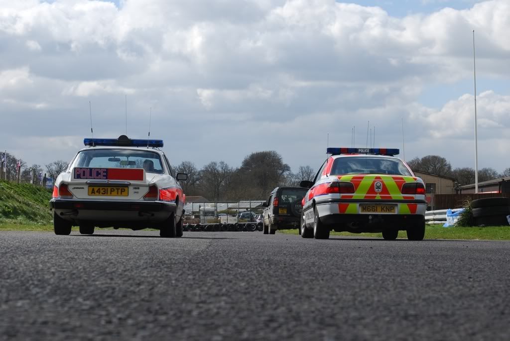

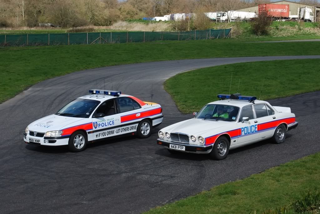

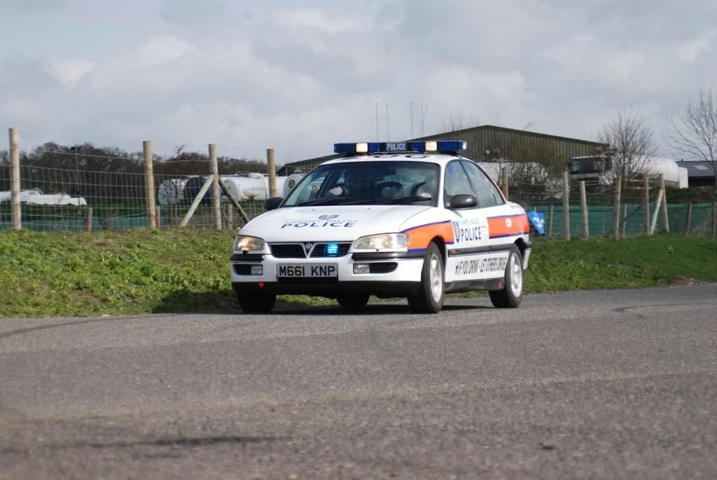

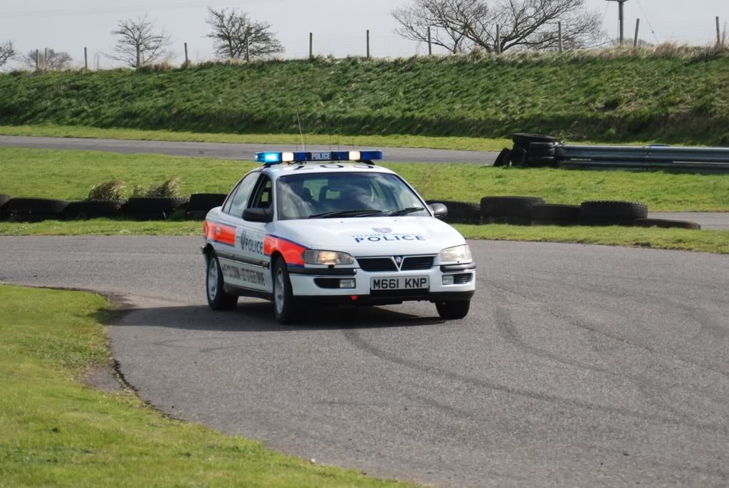

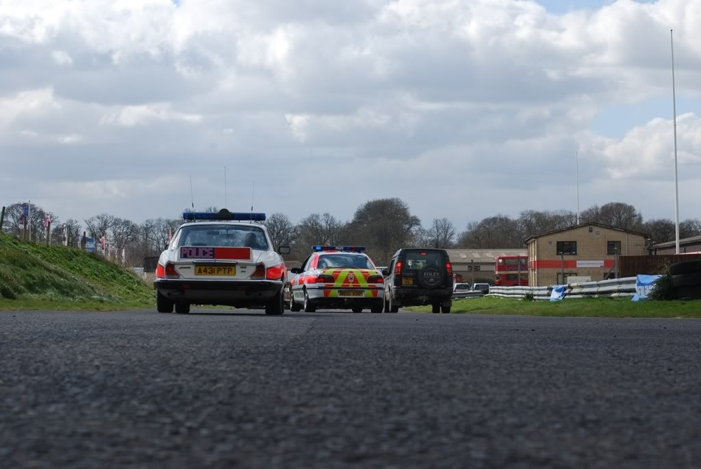

PS. Here are a few snaps taken at the Haynes Museum last month.
