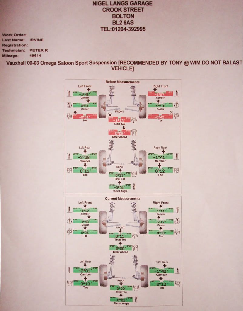

I just got back from Nigel Langs is Bolton, great bunch of guys there very friendly. The car feels fantastic now, I can't believe the difference.
As you can see the car was way out! Now running on new rubber and new settings its amazing the diffenence. Anyone for whom WIM is too far to travel and Bolton is closer I would recommend taking a trip over. Cost me £74 but it does depend on how many adjustments they have to make to the car!
