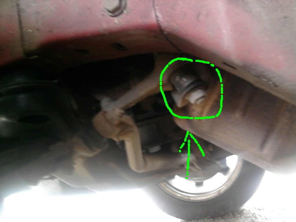

right ive had time to get under the car and give everything a shake, drivers side wheel was tight no movement or play at all,wishbones seem fine too.
But the passengers side had alot of play from the part in the picture. would this cause all the wondering and vagueness in the steering? also is it cheap enough to replace?

The part you are pointing to does look like a steering idler to me.They can be replaced by yourself,you might want a second pair of helping hands.The maintenance guide below shows you how to do it.If you can afford genuine Vx parts then get them as the pattern parts aren't much cheaper to buy but in the long run will need replacing quicker.
Here's the link how to do it :-
http://www.omegaowners.com/forum/YaBB.pl?num=1268602974
