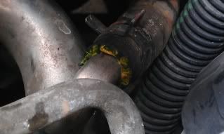

Despite swapping all the pipes, hbv, thermostat (which was buggered anyway) and radiator I could not find the source of a leak I had.  It only leaked when it ran and even then when it was warm.  I used a coolant dye to help diagnose which gave me nothing.
So, imagine my suprise when I find this:
And I start thinking
"Feck, all this prep for a head swap and the leak is a f&^%$£& hose"
At least the dye has it's uses after all even though it's a little late.  So I think oh well and carry on with the job, I might as well finish it.  Besides you never know......

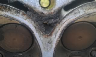

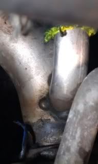

So, I got the drivers side head and suprisingly found this:
As far as I know that is not a common place to have a HG leak, however it could not have been significant as is was not showing further the block.  Or at least as far as I knew.

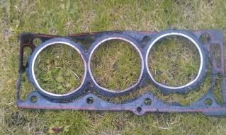

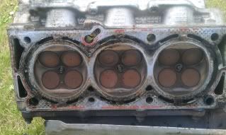

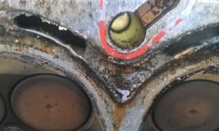

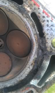

I got the head off and imagine my language when I saw this:

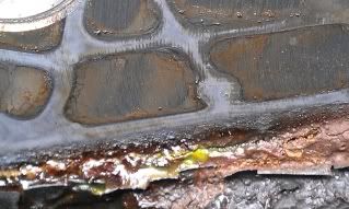

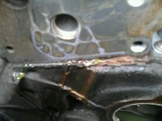

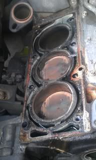

At least the block face looks unaffected, on this side at least:

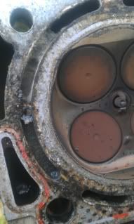

No wonder she was running warm, several of the water jackets are blocked  Shocked

The other side was pretty much the same, the HG disintergrated although there was a lot of gung at the back of the passenger side which could be a mix of oil from the rocker cover (old) and coolant although there is no way for me to tell.

what happend with the head with that deep pitting? Did the master clear it ok for action?

Kevin rightly spotted that the pitting was in an area which does not press up against the block. So I just cleared all the corrosion and filled it with a chemical metal which resists high temperatures and sanded flat with some wet and dry Thumbs Up!
