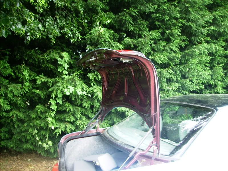

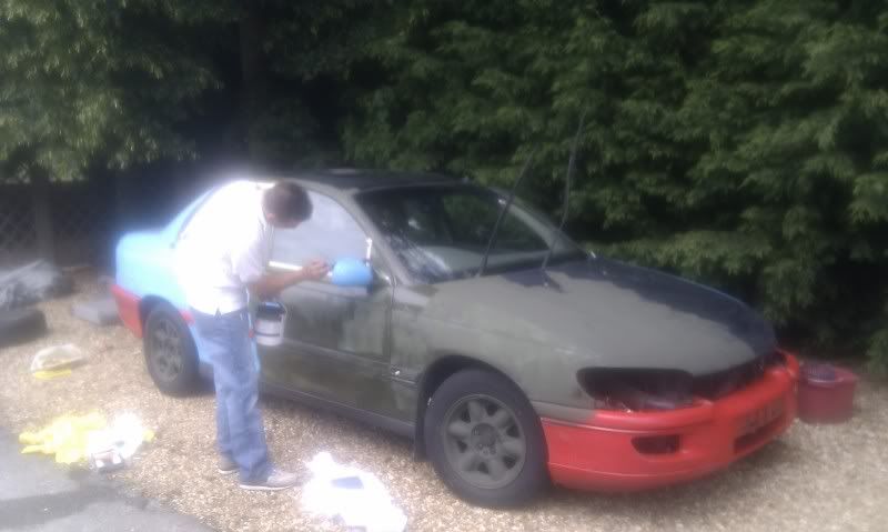

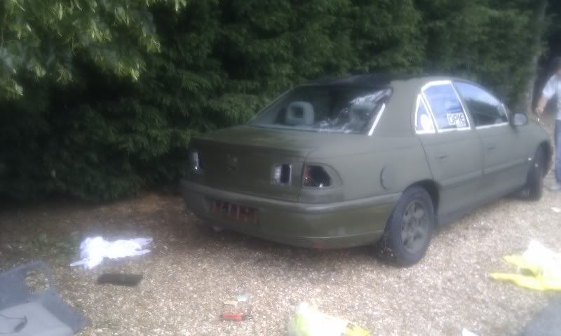

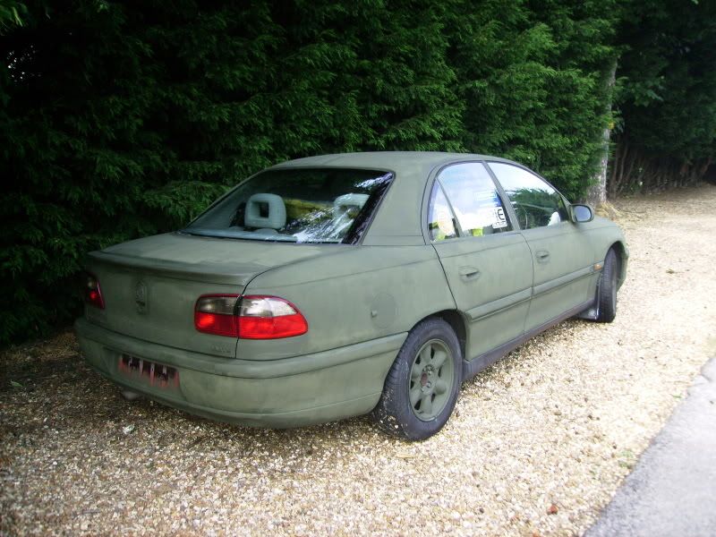

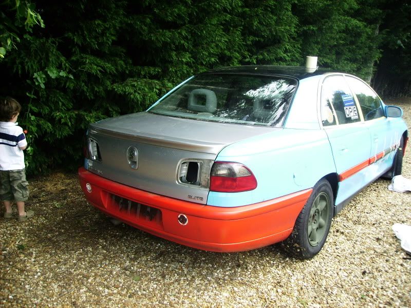

So, Billing is approaching so we thought we'd get the base colour of our "Elephant patrol" vehicle sorted.
Old bootlid ready to come off (loads of holes in it from the coal scuttle last year)
And off..
New one on..
Sidestrips Silkaflexed back on (along with the new side repeater) and sides keyed down...
Paint going on...
Few more coats..
Back on with the lights and other bits and bobs..
Spare wheel will be going here...
And there we are for the day. Next up is headgasket change and then we can start on the Elephant

Amazing it's disappeared, an invisible omega.  Cheesy

looks like that NATO IR resistant/reflective whatever paint.

Nice military green Thumbs Up! I like it Smiley

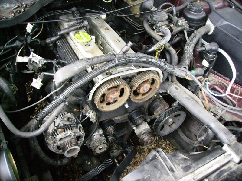

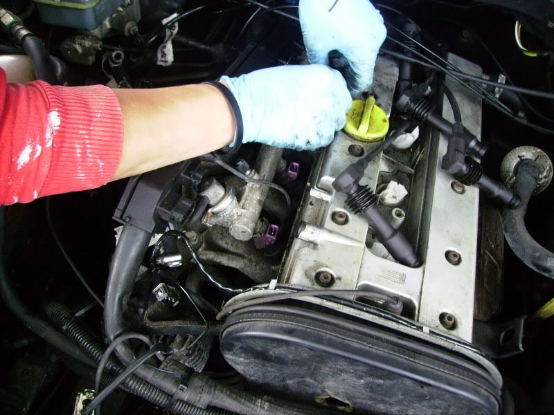

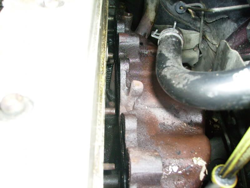

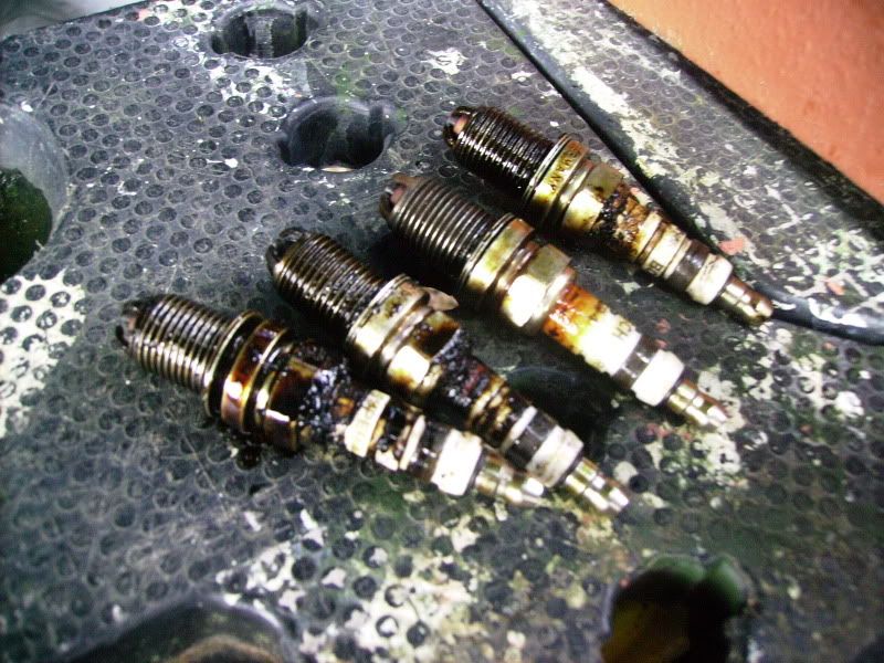

Right then, having missed Billing due to not getting the head gasket done, we're going to push for TV live...

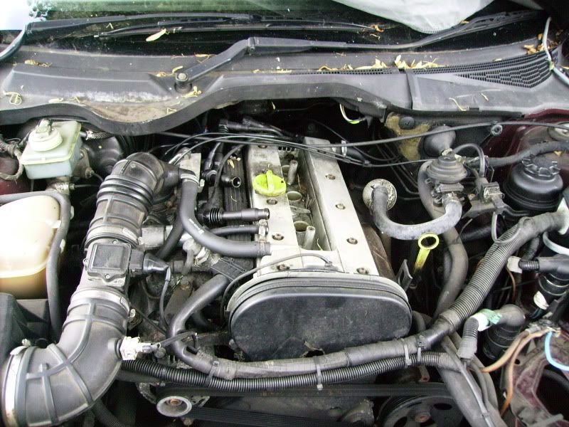

So, the mighty Ecotec..
Plugs out and looking a little oily, might have to do the valve stem seals while the head is off although oddly it doesn't use oil?

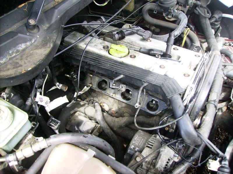

Off with the fuel rail and throttle body..
and off with the inlet manifold...
Then we removed the exhaust manifold.. (enough to get the head off anyway...
And off with the timing belt once the cams were in the recommended position to spread the load across the valves for cam removal..
And then we ran out of time as we only had a spare couple of hours this morning.
In the week, we'll get the head off and have it skimmed then will refit with the new head gasket!

Soooooo, had the head skimmed today and it was properly wonky. According to the chap that skimmed it he reckons it's been done BADLY more than once. We have a slight piston/valve interface so two head gaskets it is lol
